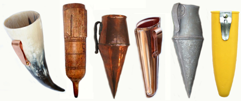

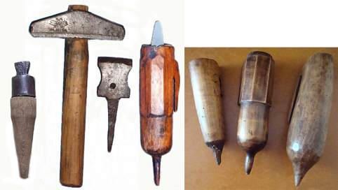

My silversmiths' raising hammers all have wider, and highly polished surfaces. The peins of this hammer are typical of scythe peening hammers - in sharpening the edge of the scythe is hit either parallel, or at a slight angle to the edge, working from about 1/2" back, or less if the blade is already thin enough... The process thins the blade, drawing the metal towards the cutting edge (making the blade slightly wider in the process). The thinner (and sharper) end of the hammer is used first, and then the slightly wider end to planish the surfcae smooth. Finally the blade is sharpened using a stone, or a strickle (a piece of wood covered in animal fat and coated with fine sand). The stone was carried in a wooden or zinc holster, or an old cow horn, hung from the belt... Often the wooden ones had a spike so it could be stuck in the ground when actullay mowing, as the holder was often also full of water..
Note the maker's mark on the hammer...
Today they also found in plastic...
Peening could be carried out in the field, the anvils are designed to be stuck in the ground, but often it was done before (or after) the day's work at home, and scythe sharpening benches are found with the anvil fastened to the bench surface.
