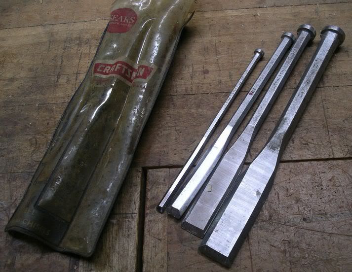

« Reply #9 on: February 06, 2012, 02:55:14 PM »
Here's a set slightly older than your Dad's...

« Reply #12 on: February 06, 2012, 10:57:29 PM »
oh nice!  now I need them...
