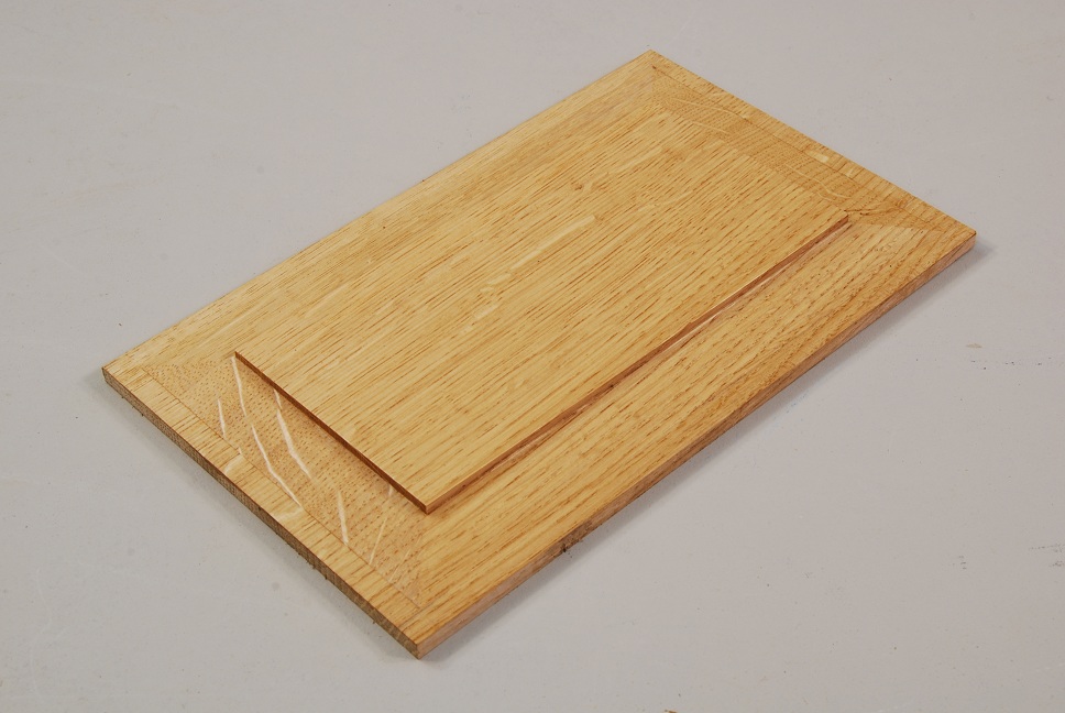

But there's no fence, no spurs, and no depth gauge.  So, in using this plane, you need to nail/clamp a batten to the work to set the width of the rabbet, and gauge the depth; and, for cross-grain work, knife heavily along the layout line for the width to avoid tearout.  This makes it less efficient to use than a No. 78.  Why did Stanley produce this plane, and the No. 10, from 1870 (No. 10's start) to 1964 (No. 10-1/2's end)?
In their catalog 110, Stanley claimed that the plane was useful "...for the heavy framing used in mining work, for carriage or wagon building, or in any work of similar nature."  I'm thinking that, at the time this catalog was issued, mining framing may have been the last place that traditional timber framing was in common use.  The Record Tool Co., in England, copied this design, producing it until 1993.  In their 1934 book "Planecraft,"* C.W. Hampton and E. Clifford of the Record Tool Company suggest that it's useful for the joiner and the carriage builder.  In British usage, a joiner "...constructs the wooden components of a building, such as stairs, doors, and door and window frames..."  British buildings, with their deep masonry walls, often have impressively deep door and window frames.  So this plane was designed for wide rabbets; I am thinking, too, that a lot of those rabbets might be exposed, and the bench plane construction of the plane would permit smoother finishes on tricky grain.  Also in "Planecraft," Hampton and Clifford demonstrate the use of this plane for fielding a panel.  If you're not familiar with fielding in panels, this is a fielded panel:
The 10 or 10-1/2 would be used to plane the slanted "field" portions of the panel.
In my own shop, I've been unable, as of yet, to find the best use for this plane.  Granted, I've not done much furniture work.  Perhaps when time permits that, I'll find the plane offers superior finish over the No. 78 that I use regularly.  But, for the $6 I paid for it 40 years ago, I'm willing to give it a home while figuring that out.
